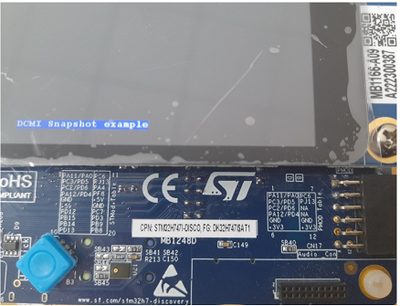

I have a trouble to interfacing B-CAMS-OMV with STM32H747I-Discovery. I used the examples DCMI_SnapshotMode on STM32CubeIDE and in other post, a ST employee said that the drivers are old and the new ones are on the github page in this link. I tried so many times to use this example with the new drivers and its not working and the LCD displays only noise. The LCD works well because I tested some LCD_DSI and works fine. I've missed something on the code?

I solved my problems with this steps:
1) in the stm32h747i_discovery file, I use thesse paramaters:
#define USE_LCD_CTRL_NT35510 1U
#define USE_LCD_CTRL_ADV7533 0U
In your zip file, the USE_LCD_NT35510 is set to 0U.
2) Also, when I downloaded the new drivers file, the STM32H7xx_HAL_Driver has missing some files and I use the old files,
Thank you for helping me!

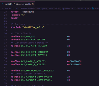

2024-01-03 8:33 AM
I'm completely new to stm32, I really appreciate your help! I have checked the wiki that you mentioned before to add drivers. I modified the stm32h747i_discovery_conf.h file like the black box below, but it doesn't work (I don't know if this is what are you trying to say). Also, when I disable the OTM8009A, I have several issues in other parts like OTM8009A_480X800 undeclared and I don't know if I have to change all this parts to NT35510.
#include "stm32h7xx_hal.h"
/* COM define */
#define USE_COM_LOG 1U
#define USE_BSP_COM_FEATURE 1U
/* LCD controllers defines */
#define USE_LCD_CTRL_OTM8009A 0U
#define LCD_LAYER_0_ADDRESS 0xD0000000U
#define LCD_LAYER_1_ADDRESS 0xD0200000U

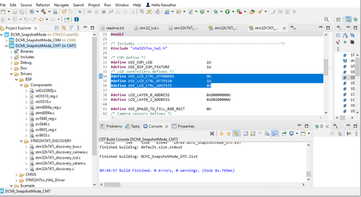

For that, I tested the DCMI_SnapshotMode example with MB1248-H747I-D03 and LCD is MB1166-A09 using the STM32CubeIDE1.14.0 version and it works correctly.
Could you please follow these steps:
1-Dowlownd the STM32CubeH7 from this link and Unzip the file.
2-Go on the GitHub STM32H747I-DISCO BSP website, and download as zip. Unzip the files and copy them in the project folder STM32Cube\Repository\STM32Cube_FW_H7_V1.11.1\Drivers\BSP\STM32H747I-DISCO by replacing the old files.
3-Download the OTM8009A LCD drivers on GitHub and place the unzipped files inside the folder STM32Cube\Repository\STM32Cube_FW_H7_V1.11.1\Drivers\BSP\Components\otm8009a by replacing the old files.
4-Create a new "nt35510" folder in \STM32Cube\Repository\STM32Cube_FW_H7_V1.11.1\Drivers\BSP\Components
5- Download the NT35510 LCD drivers on GitHub, and unzipped and copy the files in "stm32-nt35510-main" folder to \STM32Cube\Repository\STM32Cube_FW_H7_V1.11.1\Drivers\BSP\Components\nt35510.
6- Open DCMI_SnapshotMode example with STM32CubeIDE1.14.0 version STM32Cube\Repository\STM32Cube_FW_H7_V1.11.1\Projects\STM32H747I-DISCO\Examples\DCMI\DCMI_SnapshotMode\STM32CubeIDE
7- Add "nt35510.c" and "nt35510_reg.c" files to the STM32CubeIDE project. So, drag and drop the nt35510.c and nt35510_reg.c files in STM32CubeIDE from STM32Cube\Repository\STM32Cube_FW_H7_V1.11.1\Drivers\BSP\Components\nt35510 as shown in the below figure:

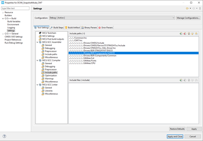

8-Add the STM32Cube\Repository\STM32Cube_FW_H7_V1.11.1\Drivers\BSP\Components\nt35510 folder to the include paths, so, click on Project->Properties and follow the instructions below:
I add in attachment the DCMI_SnapshotMode project after all modification.

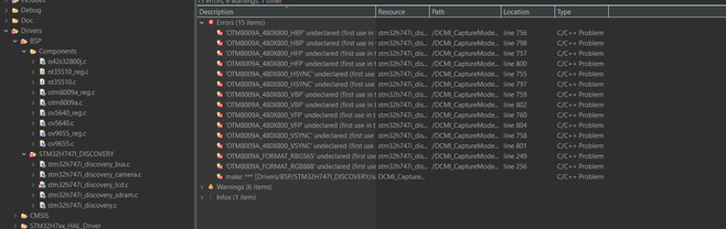

I have to thank you again to explain it to me but isn't work. I followed all the steps you mentioned and when I modified the stm32h747i_discovery_conf.h file, I have the same issue that I mentioned before. This is the error that shows on my console:
This is due the OTM8009A deactivation onstm32h747i_discovery_conf.h file, as shown in the below:
Even if I activate nt35510 and otm8009a, it displays only noise in the LCD.

-->disable the OTM8009A.
What do you mean by "disable the OTM8009A"?

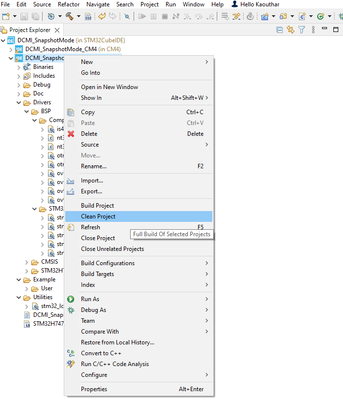

Hi @brunamark ,
Could you please try to "Clean Project" before "Build Project".
I disabled the OTM8009A and I didn't reproduced the issue.
Please make sure that Step2 is set correctly.
Please try to:
- Download the project in attachment and unzipped.
- Open STM32CubeDCMI_Example\STM32Cube_FW_H7_V1.11.1\Projects\STM32H747I-DISCO\Examples\DCMI\DCMI_SnapshotMode\STM32CubeIDE project.
-Clean Project
-Built Project.
Please let me know if the issue is solved.
