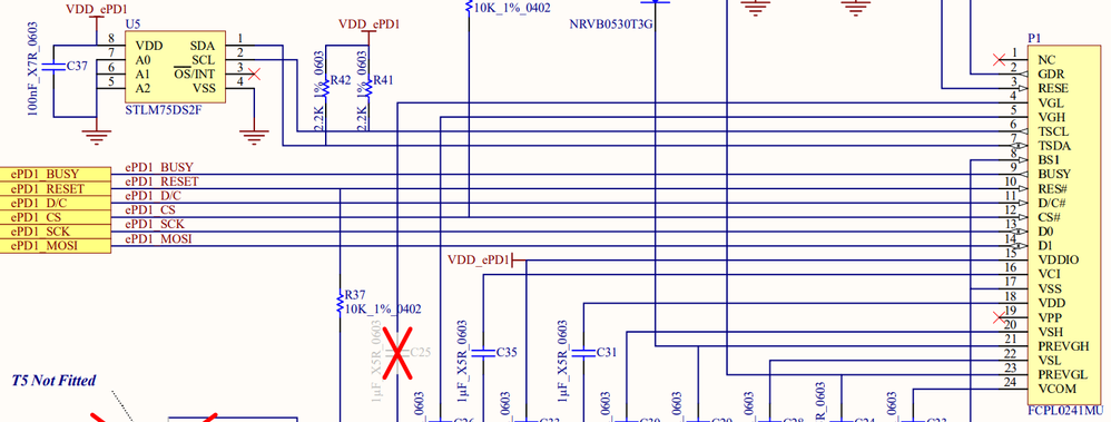

I couldn't check from the schematic diagram on UM1775 if LM75 is connected with the STM32L0538 or not.
I don't see any mention of an LM75 in any of this board's documentation:
https://www.st.com/en/evaluation-tools/32l0538discovery.html
But it does appear on the schematic:
https://www.st.com/resource/en/schematic_pack/mb1143-l053c8t6-b03_schematic.pdf#page=5
Sorry, I should have written formal name STLM75.
Could you tell me why HAL_I2C_Master_Transmit() and HAL_I2C_Master_Receive() returned HAL_BUSY.
There are something wrong in MX_I2C1_Init()?

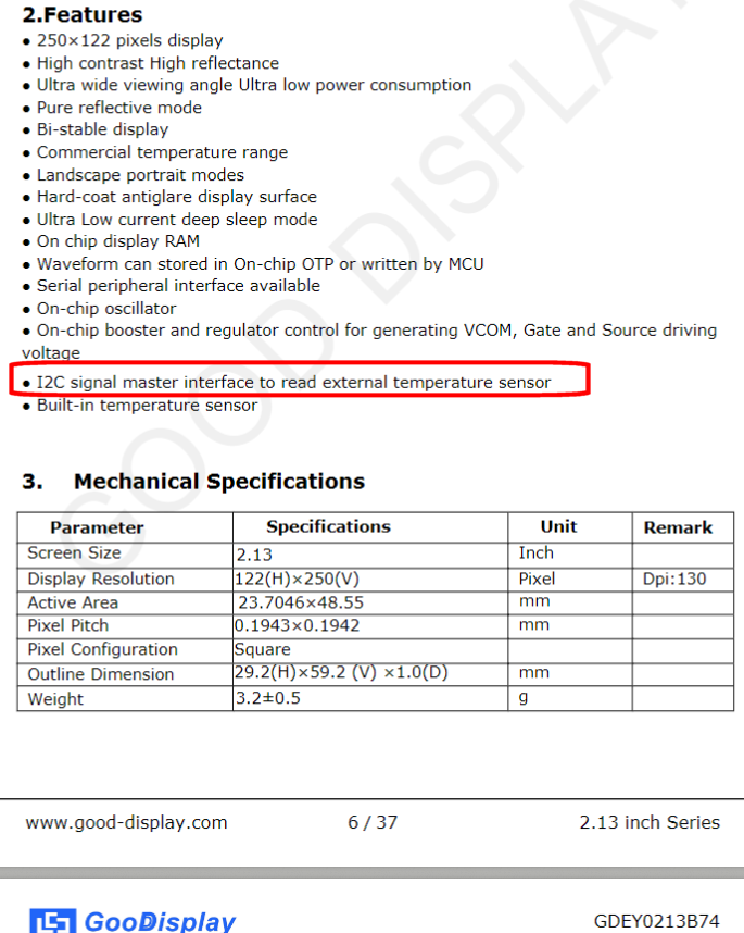

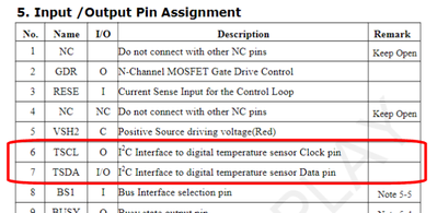

So it does look like the LM75 is not connected to the STM32; looks like it's just connected to the display - presumably used "internally" by that display?
Here's a datasheet for the display:
https://www.good-display.com/public/html/pdfjs/viewer/viewernew.html?file=https://v4.cecdn.yun300.cn/100001_1909185148/GDEY0213B74.pdf
It does, indeed, say that it can read an external temperature sensor:

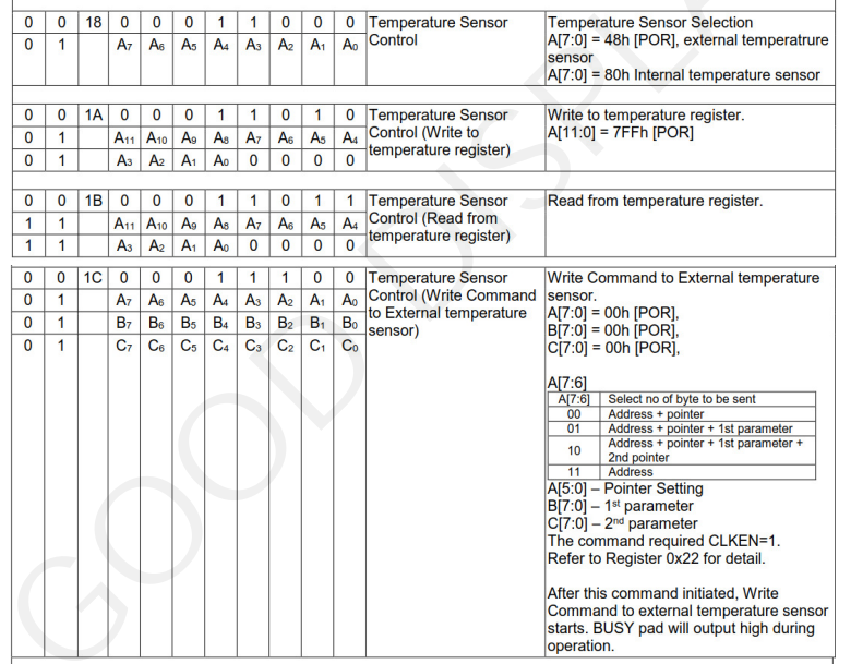

It seems you can access the temperature sensors via the display's command interface:
