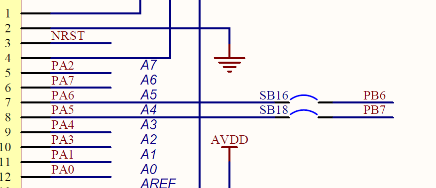

I have three GPIOs output configured. I'm having some strangeness on two of these that I don't quite understand.
I'm using a nucleo STM32L432KC, and I have some custom circuitry attached to the GPIOs (detailed below)

Each circuit is tied to a 10k pulldown resistor.
PA6
PA5
PB7
I don't quite understand a) why won't PA5 stay up, and how is PB7 somehow tied to PA5.
If anyone has some ides, I'd appreciate it.
2022-03-02 10:47 AM
Thanks! I finally figured it out,
PA and PB7 are directly connected through solder bridge on the Nucleo. I removed the bridge.

2022-03-02 10:47 AM
