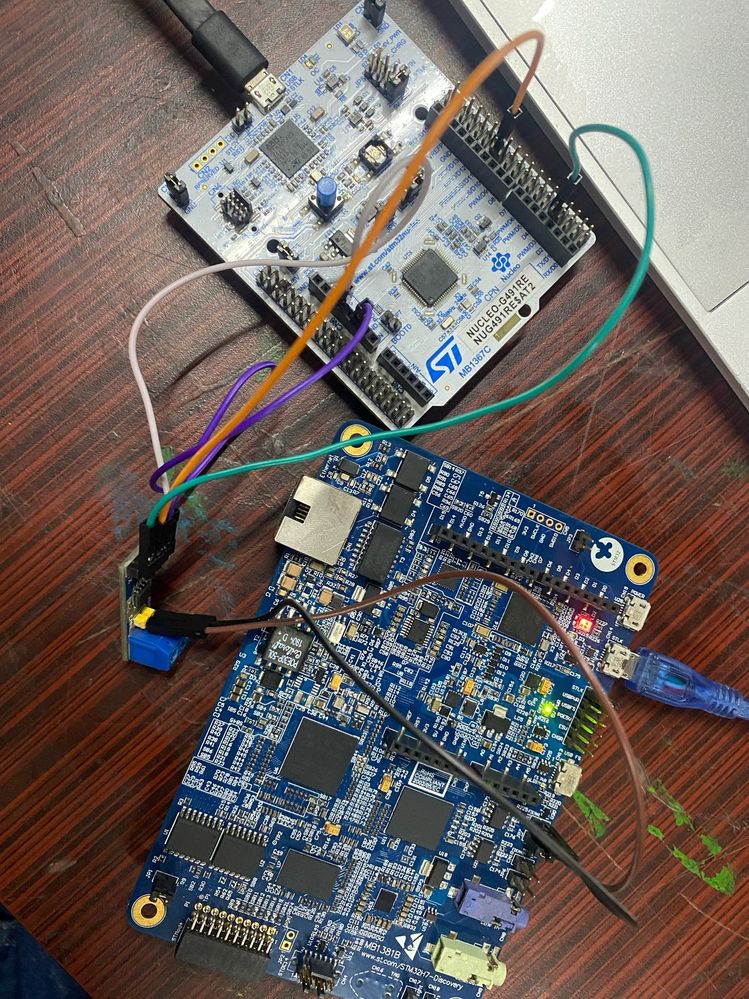

the objective of this particular project was to transmit data frames from stm32h750dbk(discovery kit) to stm32g491re(nucleo)
it is debugging and creating live expression for both of the data types in receiving and transmit end of board i have not connected any transceiver between them because it has inbuilt fdcan ports
i am attaching both the codes for g4 and h7
the picture of hardware and the live expression result when debugged separately

i have matched it to 500000 baudrate at both the ends how do i proceed further like my hardware setup is ready data is ready to be transmited at h7 live expressions and data types have been intialised too on the other end but it still aint getting trasmitted i have gone through entire process of fdcan could u pls help me out

I am implementing FDCAN communication between an STM32H750DBK (transmitting) and an STM32G491RE (receiving) with a CAN transceiver connected on the G4 side. I am using STM32CubeIDE for development.
On the H7 side, when I load data into the FDCAN transmit buffer, I can see the correct values in the live expressions window. However, when I start execution, the data does not clear from the buffer as expected.
On the G4 side, the live expressions window shows that the receive buffer is ready and initialized with a 7-byte array, but no actual data is being received. Additionally, I am unable to run both boards simultaneously in CubeIDE due to multiple ST-LINK interfaces being detected.
also the transceiver doesn't need a 120 ohm terminating resistor read tht it has an inbuilt resistor already

1- You have two issues in the RCC config with H750 Disco board:
1-1. You need to use HSE with the external crystal oscilator (25MHz) instead of HSI for CAN communication.
1-2. With a crystal oscillator you need to set Bypass configuration in the RCC.
In final you need this config:
2- Another issue in the GPIO config on H7:
You set PB9 as CAN_Tx:
while in the schematics, FDCAN1_Tx should be PH13:
That's why every time I ask to check the hardware.
I've modified some parameters in your ioc files and in your projects. I've attached a zip file containing both projects.
As you can see G4 is receiving the CAN messages in live:
Migrate to CubeIDE V1.18.0/CubeMx 6.14.0.
If you didn't succeed with the modified projects, I'm pretty sure it's an issue in your HW. Therefore I will close the thread after a period of time.
Hope that helps.
