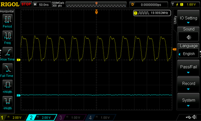

2024-04-25 11:48 PM - edited 2024-04-25 11:50 PM
From my tests :
20 MHz can get from H743 , at 480MHz , -O2, : 25ns hi or lo time ;
compared to cpu with "better" = direct access to port/bus : H563 , at 250MHz :
4ns pin access, 16ns with while-loop : 82MHz output by pin toggling - not bad , i would say...
see:
