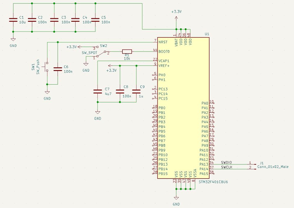

Schematics attached.
I read the datasheet a few times as some of you advised, and I came up with a minimalistic circuit.
Again, I just want to power on the naked MCU I have, boot it, and load a simple program via SWDIO/SWCLK pins. I made schematics on KiCAD for this. I'm doing this on a breadboard (I know, some might say it will not work, but I asked ST support, and they told me that if I make my connections ‘solid’, they don’t see a reason why it wouldn’t work)
There is something I don't understand, the datasheet seems to indicate that I need to connect the VREF+ somewhere, I think I understand that I should connect it to VDDA which in my UFQFPN-48 package I don't have as a separate pin (the datasheet on page 33/139 says that the pin 9 is VDDA/VREF+ and it says that pin 8 is VSSA/VREF- so I'm more confused now, looks like VREF+ and VDDA are the same pins, and after reading 'power supply scheme' on page 56/139, I decided to wire VREF+ to VDD, in a similar way as the rest of VDD and VBAT, with decoupling capacitors.
I also read the AN4448 (hardware development for STM32F4xxxx) and it says on pages 25/50 and 26/50, that the boot modes are selected by the state of BOOT0 and BOOT1, but I don't have BOOT1 (actually I couldn't find BOOT1 in any package for this MCU)
So, right now, I'm not sure if I'm wiring VREF+ correctly, and I'm not sure how to select each of the three boots modes with only BOOT0
My schematic is here, if anyone cares to review it and critique it, that would be nice.
