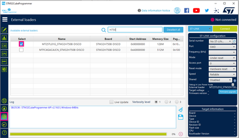

Could you please check the memory flash size, page size, dummy cycle...
Are you able to upload a .bin file using the available external loader in STM32CubeProgrammer without issue?

Yes, I'm able to upload .bin file using the external loader available in Cube Programmer.
But the custom file which I created is giving us this issue.

Glad to know that you are able to upload .bin file using the external loader available in STM32CubeProgrammer.
I noted in the .ioc file that the flash size "23" is wrong and should be "27". Please check the dummy and page size.
I recommend you when create your customer loader to start with an available example like as MT25TL01G_STM32H743I-EVAL and to follow the steps shared in How to implement and use your own external flash l... - STMicroelectronics Community FAQ.
