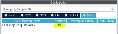

Why do you have EXTI15_10_IRQHandler inside the while loop?
while(1){
void EXTI15_10_IRQHandler(void) {
HAL_GPIO_EXTI_IRQHandler(GPIO_PIN_12);
HAL_GPIO_EXTI_IRQHandler(GPIO_PIN_13);
}That is already in stm32xxxx_it.c file.
Did you enable the NVIC for that GPIO?
