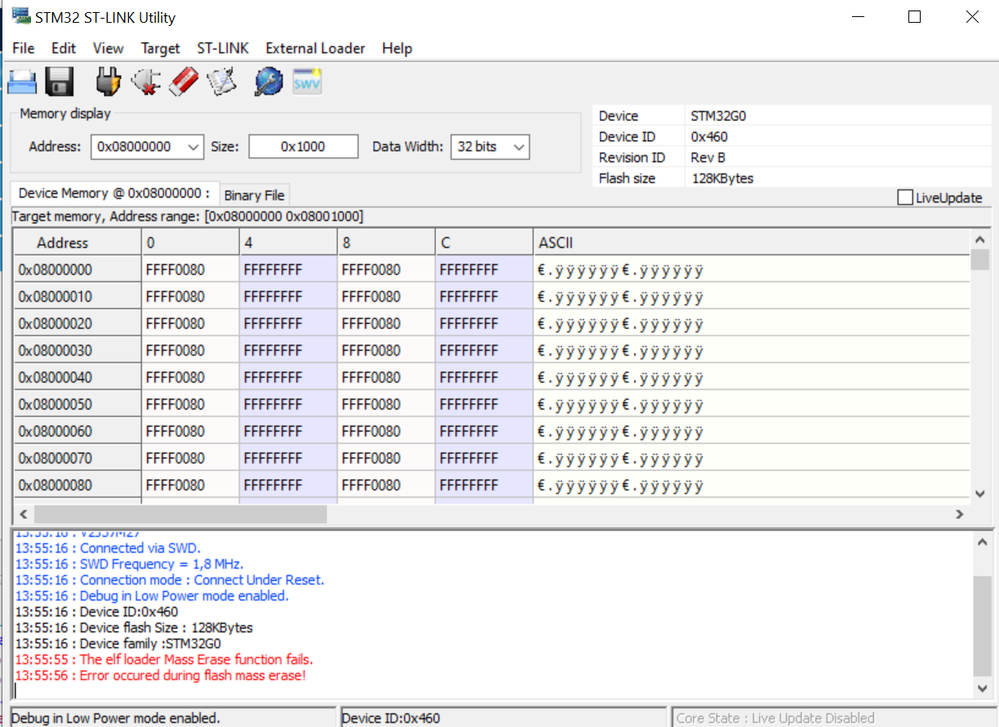

When i try to perform a full chip erase, i get the error: mass erase operation failed. please verify flash protection. I tried doing it sector by sector but get an error. I tried a few times and disconnected and reconnected my board. I'm not sure where to verify flash protection.

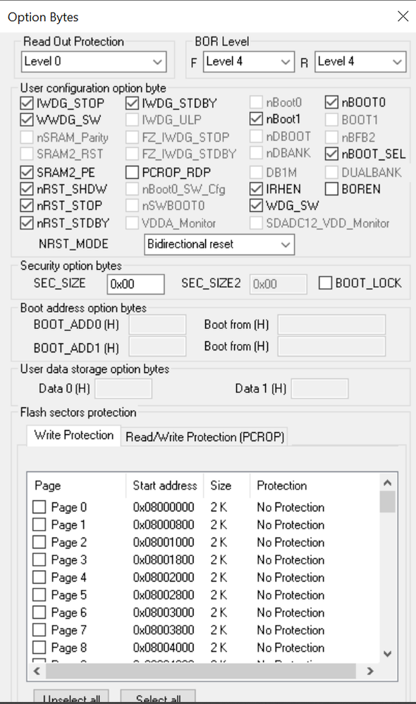

What chip? Show a screenshot of the option byte values.

I tried using both ST-Link Utility and STM32CubeProgrammer and get the same failing error on both.
2021-06-09 1:25 PM
So STM32G0, ST-LINK Utilites does look to be having issues reading the memory, not clear why.
