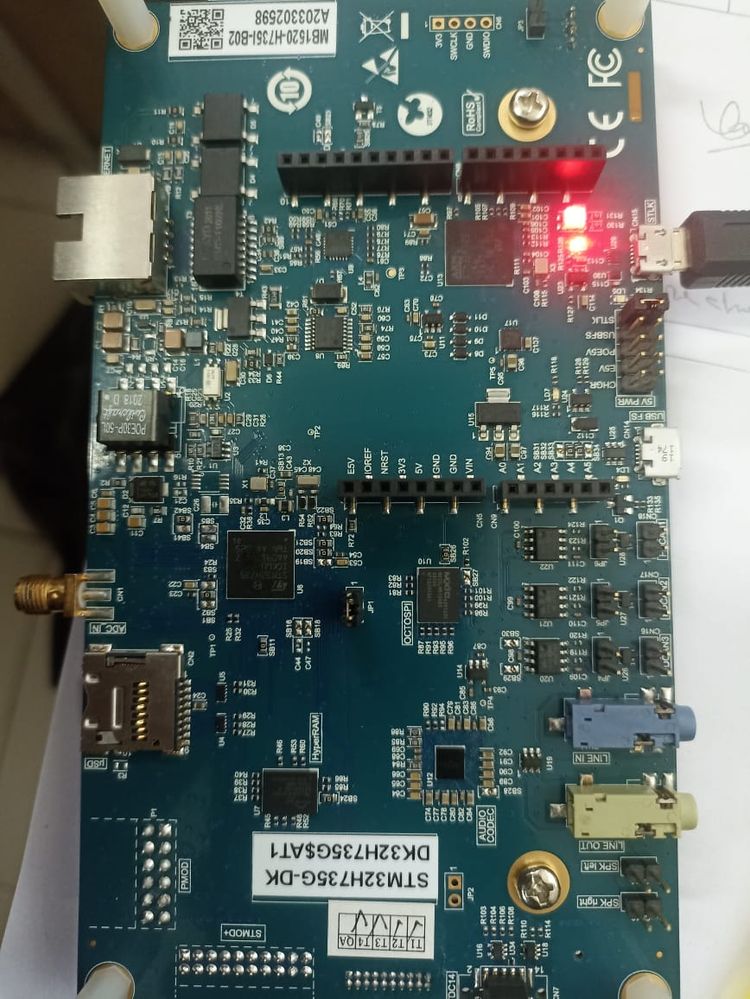

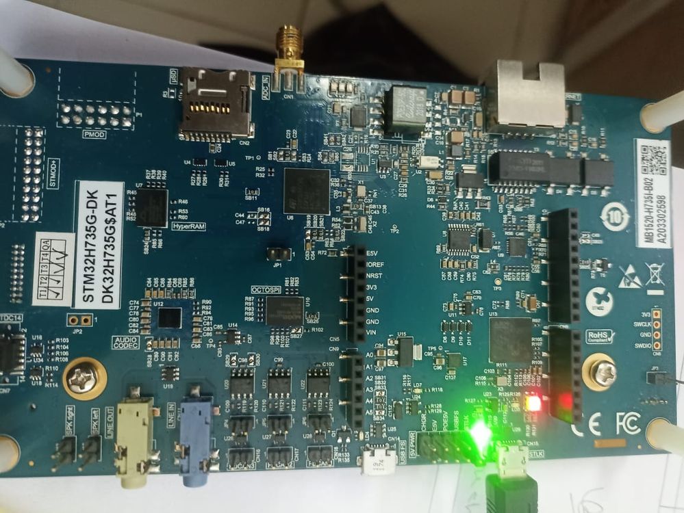

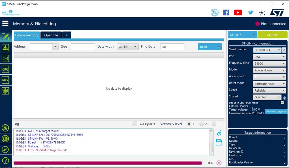

2023-01-03 2:42 AM
Hi..
I followed to connect board under power down mode but still getting same issue No STM32 target found!.
here i have attached image for your ref.
2023-01-03 2:56 AM
And one more LED LD3 continue ON..
This LED is for STLINK-V3E Over Current.
