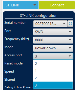

You need to select the access port number 3 in STM32CubeProgrammer before to connect:
2024-03-11 8:17 AM
Connect to the device over access port 3 to recover the device. This is a setting on the right side of STM32CubeProgrammer.

I can’t see access port 3 on my STM32CubeProgrammer. There is only access port 0 on there. Also the target voltage goes down to zero. I think I need another solution.

I solved the problem. It was not about the CubeProgrammer version. When I only use STLK input, the target voltage goes to zero and I could only see the access port 0. I used both STLK and POWER inputs and then I could see the access port 3 and enabled the cm7.
