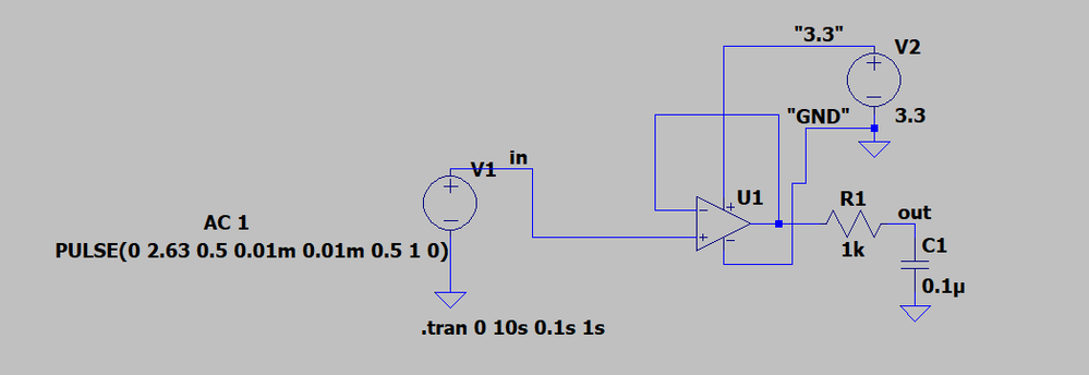

Therefore, I tried to follow your instructions, and I created a simulation model with LTspice.
Here's below the schema I drew, does it match with what you thought about it some hours ago?
Here, V1 corresponds to the voltage output of the voltage divider.
V2 corresponds to the power supply outputs of the STM32 board ("3.3V" and "GND") I'm going to use to supply the opamp.
At the output of the opamp, there's the simple RC filter which has a cutoff frequency of 1.6 kHz.
I truly thank you in advance for your help!

Yes, that looks very good.
Maybe you have to adapt the capacitor size to your signal.
For the opamp, look for some "single supply RRIO" (rail-to-rail input / output) which can work with 3.3V ***, and spend another 100 nF cap close to the opamps VCC / GND pin to connect between 3.3V and GND.
So now connect that circuit between the input divider / filter and the STM32 IO.
*** opamps: ss we're at ST here, you might use:
TSV991A
TSV6390
I hope you can solder that... ;)

Well, remember that this might not yet be the solution to your EMI problems, maybe only one of many steps.
Remember the case and check how to ground it.
