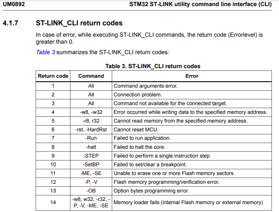

Since STM32 STLINK Utility Command Line Interface has return codes, why STM32Cube Programmer don't have?

Please document what the actual return codes are, the answer here isn't particularly satisfactory if someone searched on it, or the forum suggested it as an answer.
2021-09-06 5:54 PM
Yeah agree. It would be good if can have the list of return codes like what we have for STLINK Utility CLI user manual.

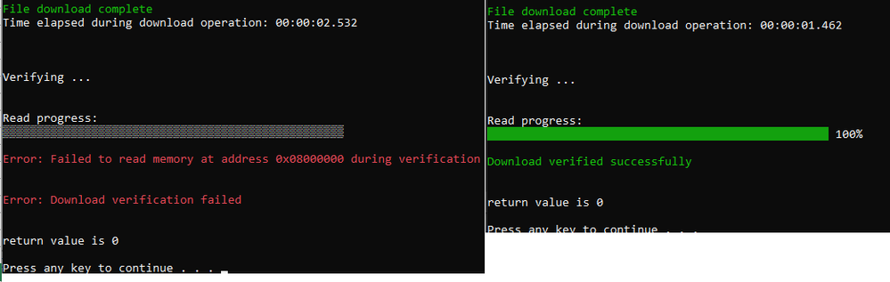

Hopefully can be fixed soon. My product's manufacturing process depends on returned-code to detect failure in programming.
Now always return zero in any condition: STM32CubeProgrammer (2.8.0)

2021-09-28 12:32 AM
This is the script I use:
@echo off
SET COMMAND=stm32_programmer_cli -c port=SWD freq=8000 mode=UR
SET FILE=%1%
echo.
echo %FILE%
echo ===================================================================
echo SURE TO ERASE-PROGRAM-VERIFY? Press Ctrl+C to cancel
echo.
pause
%COMMAND% -rdu -ob WPRMOD=0 WRPOT0=0 WRPOT1=0 WRPOT2=0 WRPOT3=0 WRPOT4=0 WRPOT5=0 WRPOT6=0 WRPOT7=0 -e all
echo return value is %errorlevel%
%COMMAND% -d "%FILE%" -v
echo.
pause
