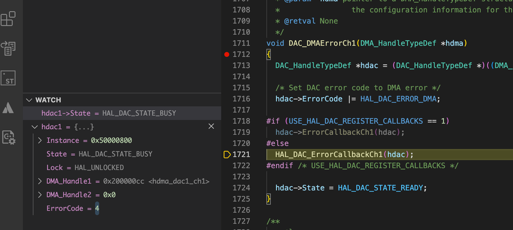

I just set a breakpoint and started up and it looks like the DMA error callback is getting called and setting to an error code 4:
