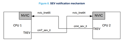

2024-03-14 6:28 AM
Use the send event (SEV) instruction to send an event to the other core to trigger an interrupt.

2024-03-14 2:16 PM
> Would you say that the cpu offloading effect is not very relevant in the dual core architecture given?
My main point is that if data is available to the M4 core, it's already available to the M7 without moving it, and vice-versa (except for some special memory locations). No DMA/BDMA action necessary. You just need to know where it is in memory. You can do this with a memory pointer set to the same location on both cores, and with that space carved out in the linker file so it's not assigned to anything.
