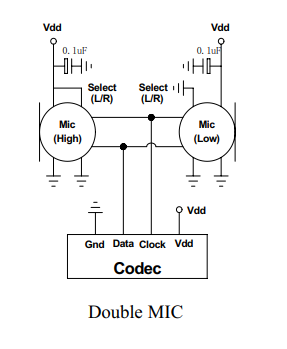

L/R is the WS(Word Select) signal, if you use mic , that has a select pin for this and works with standard I2S interface. (You didnt tell, which mic you want to use.)
On other mics, the clock is switching L+R channel and L/R setting hi or lo , is your choice, which mic should be on "L" or "R" channel.
Here the I2S input needs to be switched to PDM mode, because both signals , rising and falling clock, are used to latch the data,
and/or WS not used at all and conversion PDM -> PCM is done in software only.

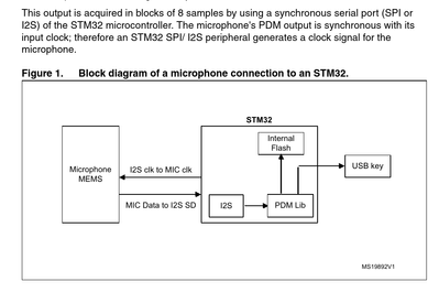

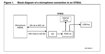

Read AN3998 , PDM audio software decoding on STM32 microcontrollers .

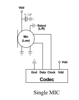

I have to use only one Digital Mems microphone in my case . I am know concept of the pin L/R working .But my question is How to connect my Mems Microphone pin to Stm32F407 Discovery board .I have to attach my Mems microphone and Configuration of I2S communication in my STM32 CubeIDE in Below.I am need your full explaination of my doubt.
