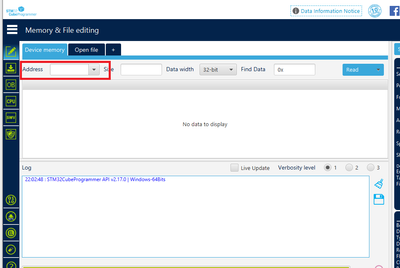

Is there a application to program individually the .bin file separately apart from STM32CUBE IDE.
You can do it with STM32CubeProgrammer but you need to put the first address of the flash as .bin file does not contain the addresses like HEX file.

If you are looking to program the .bin file on your MCU, you have to generate it using CubeIDE and programme it using CubeProgrammer.

2024-08-27 2:16 PM - edited 2024-08-27 2:25 PM
No this is an old and depricated tool called STLINK-Utility.
This is the link to STM32CubeProgrammer: https://www.st.com/en/development-tools/stm32cubeprog.html
