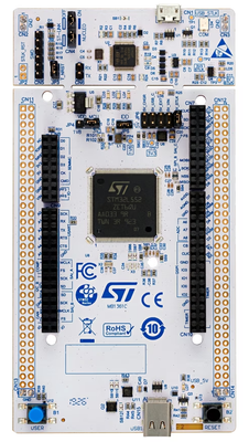

Either: Nucleo board NUCLEO-L552ZE-Q as a basic board:

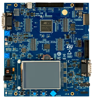

Or the evaluation board STM32L552E-EV
with a superset feature:
For more details refer to their respective links.

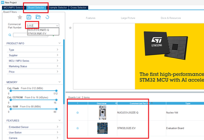

You can also use STM32CubeMx for fast search of the available boards to your device:

Not every part has a development board
Perhaps use the NUCLEO as a proxy
https://www.st.com/en/evaluation-tools/nucleo-l552ze-q.html
