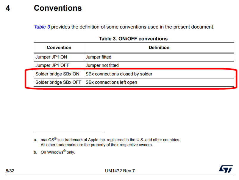

As already noted, "SB" is a Solder Bridge:
Just like a Jumper ("JP") it allows a connection to be easily made (closed) or broken (opened) - to allow configuration to a user's requirements.

They use these Solder Bridges rather than traditional Jumper links because:
In some cases, rather than just use a "blob" of solder, a zero-ohm resistor (aka "zero-ohm link") will be fitted:
