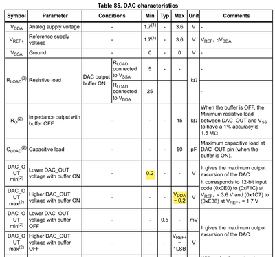

The DAC is not perfectly rail to rail when the buffer is enabled. If you disable the buffer then rail to rail performance improves but the output impedance goes up significantly.
Even "rail to rail" op amps don't actually go the entire way to the rail. Typically they will stop around tens of mV from each one.
