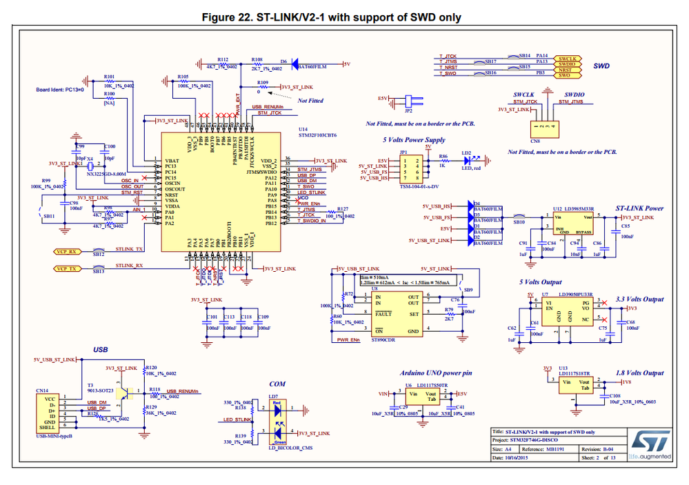

We're designing a custom board for a customer with the STM32F746 DSP and we wanted to remove the external programmer so it would be easier for them to upload and debug their own code. In order to do this, we copied the schematic from the Disco board using the SWD connection.

We can neither program nor debug. We copied the implementation done here:

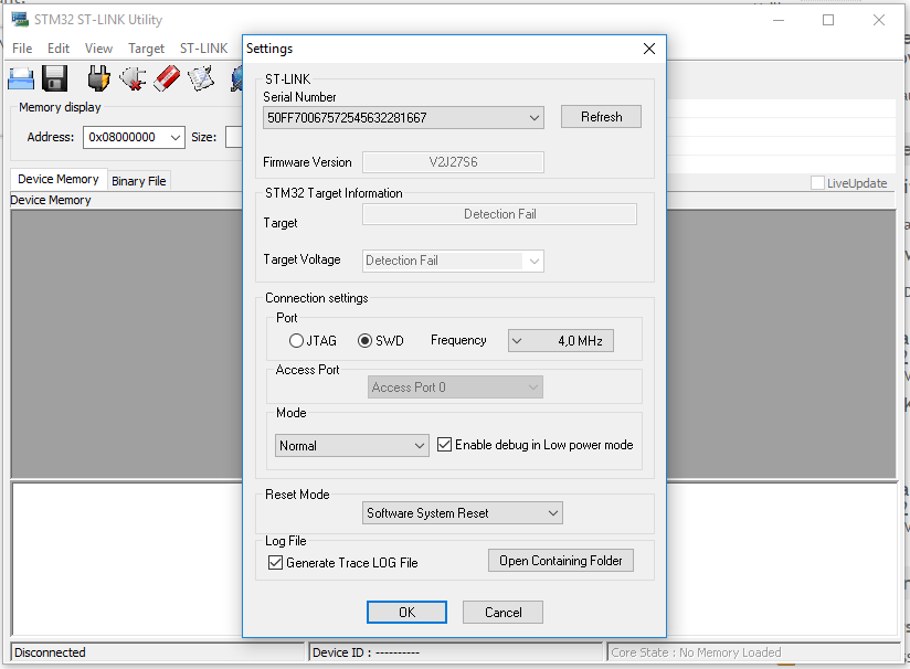

This is the dialog window when using the STLink Utility:

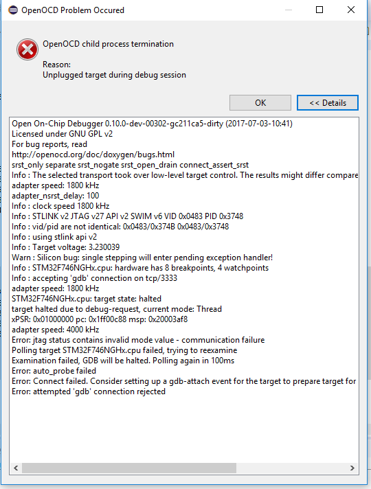

As you can see, we can't even detect the target MCU (STM32F746). Also, when we try to program it using SW4STM32, this is the output:

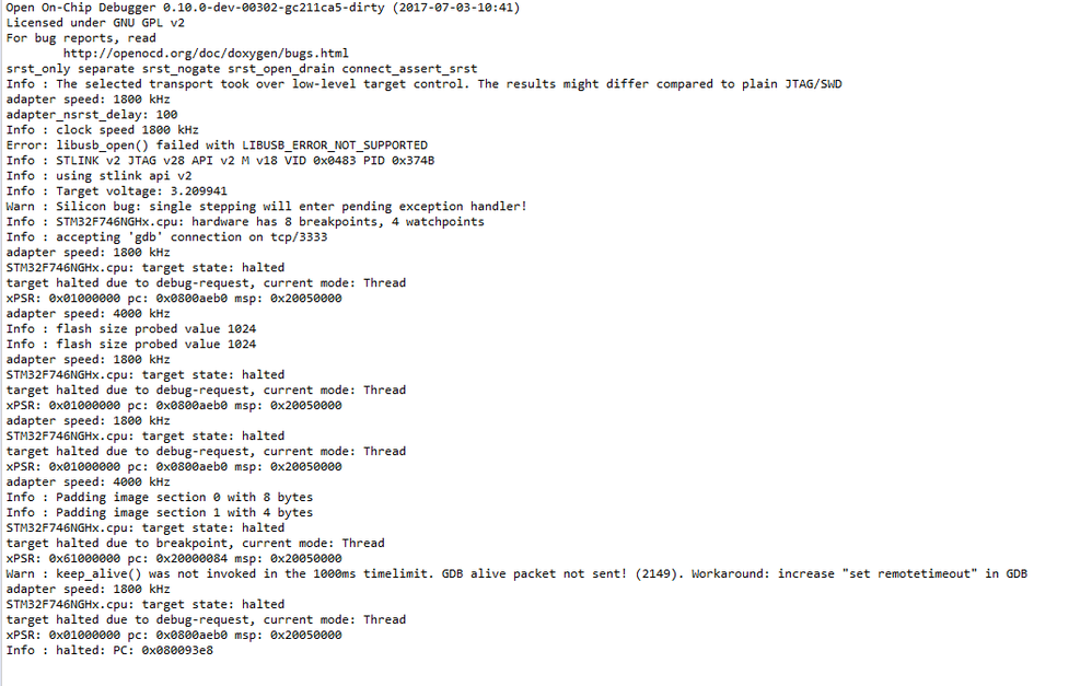

It seems like it's trying to use the JTAG connection to program, but we're using the exact same options as when we program the STM32F746G-Disco board. And that is always successful:

Holding the reset low gives the following message:
Info : accepting 'gdb' connection on tcp/3333
Error: auto_probe failedError: Connect failed. Consider setting up a gdb-attach event for the target to prepare target for GDB connect, or use 'gdb_memory_map disable'.Error: attempted 'gdb' connection rejectedWe’re moving the ST Community to a new platform to give you a better and more reliable community experience.
