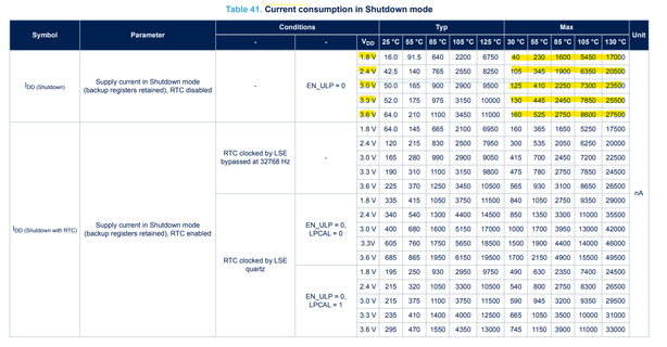

Hello @Seth1er,
Could you please refer to the STM32U031 datasheet and check the maximum current consumption precisely table 41. Current consumption in Shutdown mode. The current consumption in shutdown mode may exceed 100 nA for certain conditions and temperatures.

2025-03-11 1:18 AM
hello,
thank you for your reply.
The test is done with 3.3V at ambient temperature, (below 30°C).
but the issue here is more about the standby current than the shutdown that is not in the expected value.

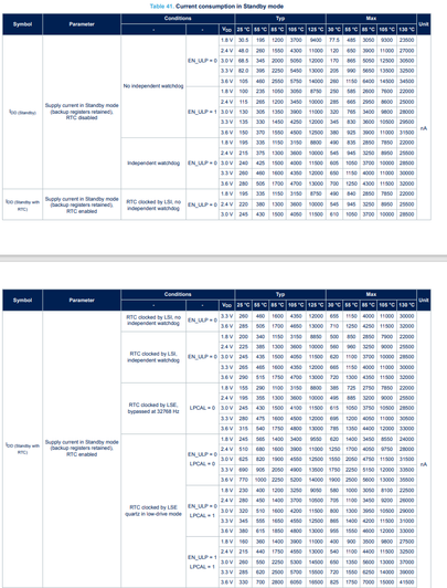

2025-03-11 1:33 AM
Hello @Seth1er,
Thank you for updating post.

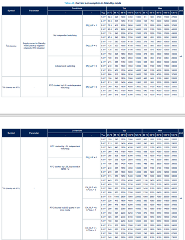

I noted that the standby current consumption with RTC may exceeds 600 nA for STM32U031 as shown in DS14581 - Rev 2 (STM32U031) table 40. Current consumption in Standby mode.
For STM32U083 also the standby current consumption with RTC may exceeds 360 nA. Please take a look at Table 41. Current consumption in Standby mode DS14463 - Rev 2.
I made a custom board with a STM32U031 and measure the standby and standby+RTC current. The value was very high (µA)
--> what value did you find? and under what conditions (the RTC clock source)?
