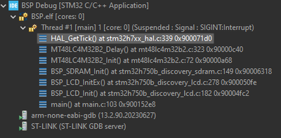

2024-07-07 10:55 AM
I'm having exactly the same issue with the same board, but with a newer firmware version, STM32Cube_FW_H7_V1.11.2
This is the call stack:
The example is being build without any modification.

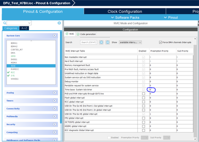

2024-07-09 8:28 AM
Can you try lower the SysTick priority to 0 and other to > 1?
That might work as it works for me!
Ayoub
2024-07-09 1:10 PM
The BSP project for the STM32H750B-DK kit doesn't come with a .ioc file.
I changed the SysTick interrupt priority to 0, but still hanging on the HAL_Delay.
It's just really weird, the most basic demo project of the kit simply does not work out of the box.
If even the ST engineers struggle to get this kit running, how am I supposed to learn how to use it?
2024-07-10 1:28 AM
So you have SysTick interrupt priority set to 0 and all others > 1? can you please make a screenshot of your NVIC config?
2024-07-11 9:31 AM
As I said, the BSP project does not come with an .ioc file, so I can't configure it with MX.
What I did was:
still no luck...
If I start a new project using MX, the systick works fine, so I'm sure the board is not defective.
