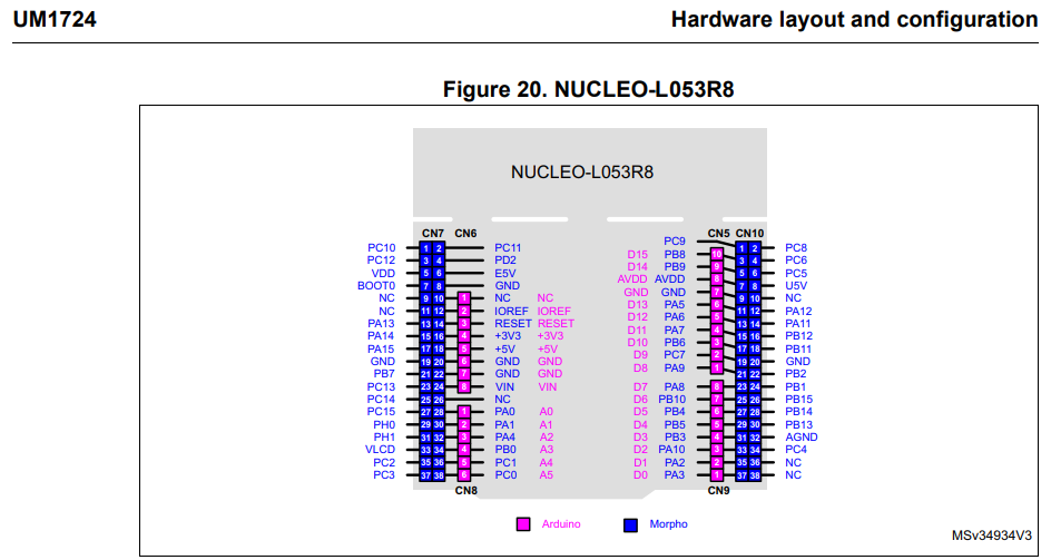

The only USB connection on the Nucleo-L053R8 is the ST-Link - you cannot connect those directly together!
As @Tesla DeLorean said, if you want a UART connection, just wire between the UART pins on the Arduino and/or Morpho connectors:
Check the Datasheet for UART pin assignments:
https://www.st.com/en/microcontrollers-microprocessors/stm32l053r8.html#documentation
Note that the ST-Link's VCP connects to PA2 and PA3 - so you'll have to disconnect that to use those pins.

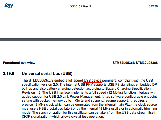

@FBL wrote:Configure the USB OTG peripheral on the Host board to operate in Host mode.
Configure the USB OTG peripheral on the Device board to operate in Device mode.
But the STM32L053R8 (the device on the Nucleo-L053R8) doesn't have OTG - it's Device only:

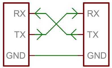

How many USB Cable do I need to upload the code? As I'm a beginner I do not know how to establish connection between 2 mcu boards. What I did for now is only connecting Tx-->Rx , Rx-->Tx and random 2 ground from each board connect together using manual connection

@Desireee wrote:What I did for now is only connecting Tx-->Rx , Rx-->Tx and random 2 ground from each board connect together using manual connection
That's correct - and not specific to STM32:
https://learn.sparkfun.com/tutorials/serial-communication/all
