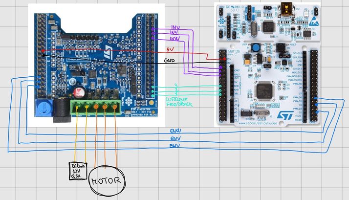

I need to connect the NUCLEO-IHM16M1 driver with STM32F308 but due to smd resistors soldered on top of the driver NOT compatible with my STM (and not having the right tools to desolder them) so I can't attach/put/stick the driver on top of the ST (as is usually done).
I decided to manually connect the two boards with wires:
(the connections in the drawing are random, don't look at the pins!)
I tried connecting as in the picture but nothing lights up on the driver, not even an LED.
The cases are two: either the driver is burned out (likely because it was used by others before me) or some connections are missing to the ones I have already made.
My question then is: are there any connection missing besides the ones in the picture? ... that are: enables, currents feedback, inputs, and 5V?
Other suggestions are open but let's not talk about how to desolder smd components because that's not what I want to do ... I want to manually connect wire to wire.
Thanks.
2024-07-04 2:06 AM
@luke514 wrote:not having the right tools to desolder them
You don't need special tools to desolder them!
All you need to do is remove them - that can be done with pretty much any soldering iron.
