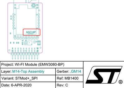

That's just a schematic - don't you have a link to ST's Product Page for that board?
2024-07-01 6:45 AM - edited 2024-07-01 6:45 AM

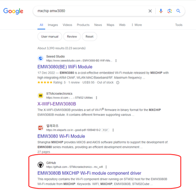

OK, so that schematic has this in it:
A quick google for that part number gives:
https://github.com/STMicroelectronics/mx_wifi
