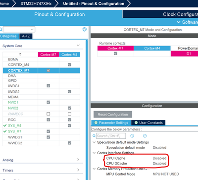

I am wondering how to configure the MPU in CubeMX (6.12.1) so that I can enable the D-Cache and the I-Cache. I know the instructions that enable the caches (SCB_Enable_x_Cache(); replace _x_ with I or D) but was wondering on the configuration CubeMX generates.
I am using the STM32H747I-Discovery board and CubeMX produced:

To enable data and instruction cache, enable them in the CORTEX_M7 tab, just above the MPU. No additional MPU configuration is needed as the default will allow them to be cached.

Thank you for the additional information. I had enabled the MPU but did not understand the setting in CubeMX.
I did not make any changes in CubeMX for the MPU (except enable it) when it generated the code. The "MPU_InitStruct.SubRegionDisable = 0x87" was what CubeMX generated, I did not even know what exactly it meant.
