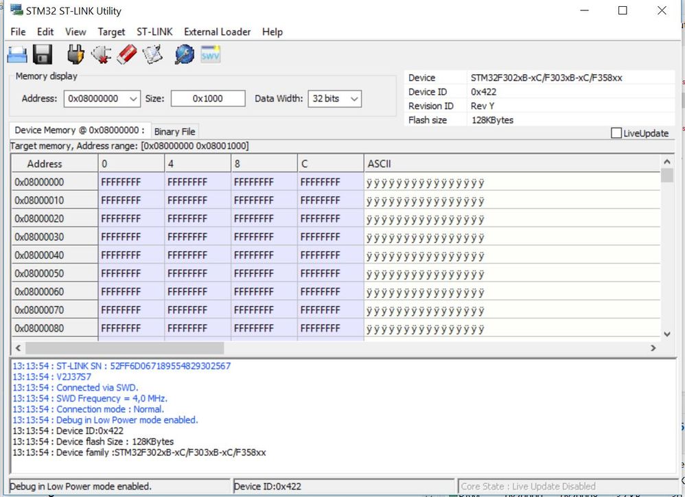

I just powered up my own board and i just wanted to start debuging.
The first thing i tried was to connect with the STM32 ST-Link Utility and an ST-Link V2.
This works fine. I can connect via SWD and can read the Chip-ID and see the Flash.
In terms of the hardware everything seemed to be fine for me.

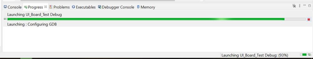

So i continued with setting up the newest Cube IDE which i just downloaded. (Version: 1.5.0)
I set up an example project, with my processor and SWD enabled and tried to start debugging. But this is where i encountered the problem. When i was starting the debugging session, it took forever to connect, showing the following debug log:

Device CPU : Cortex-M4this took some minutes.
and the following progress status appeared for some time:
After some time, the debugging session showed the following log:

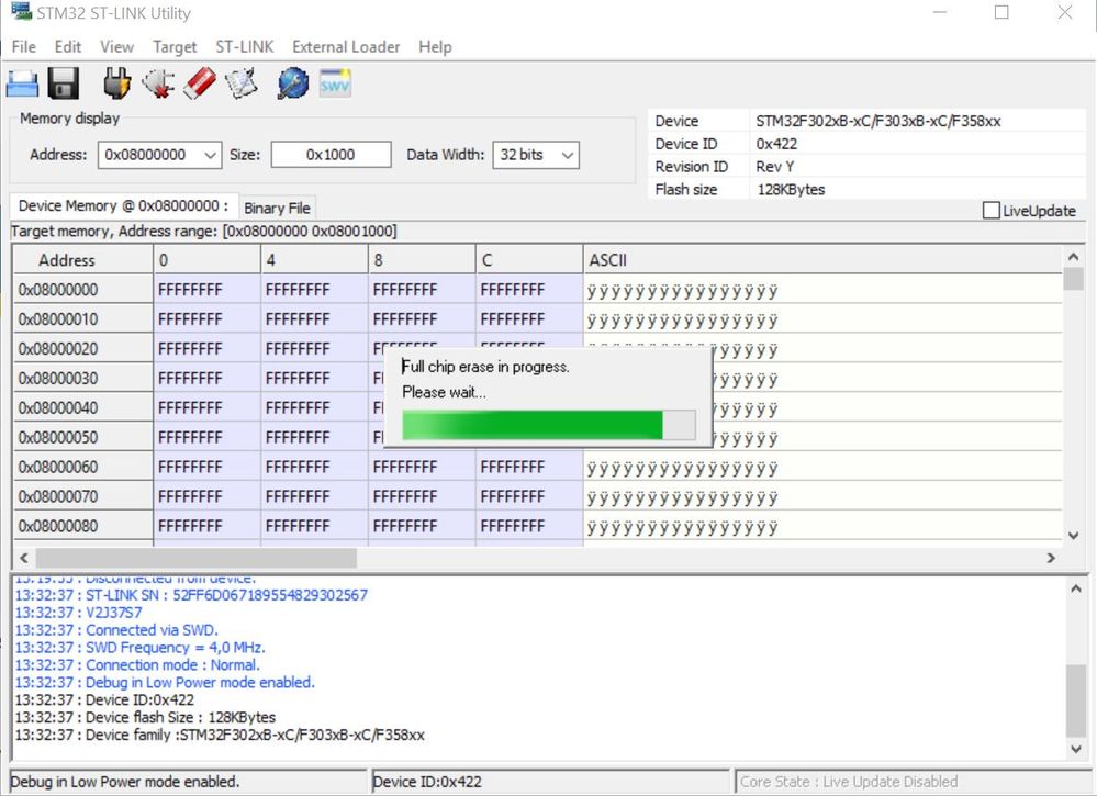

2020-12-06 5:34 AM
Resolved! - the problem was caused by an instable power supply!

Just found out, that a full chip erase in stm32 st-link utility wont complete and does not work.
