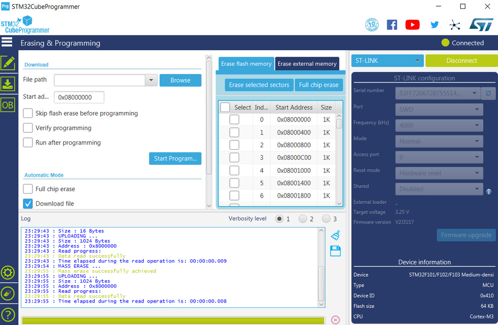

I have also try to download, read, erase MCU by STM32CubeProgrammer and it works correctly.
Project was made by STMCube as Atolic project and after that it was converted to STMCubeIDE project. Firmer, which is made by STMCubeIDE and downloaded in MCU by STMCubeProgrammer works as expected.

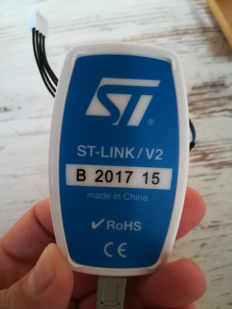

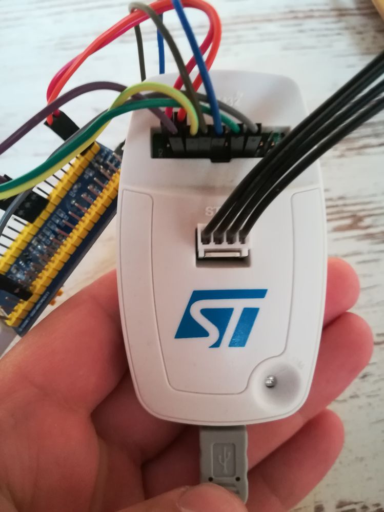

ST Link v2 is original STM product bought from famous distributor in EU. You can see picture below.
BluePill is bought on open market but MCU is origin STM product. I hope, I can not believe that there are "fake" STM MCU's on market.

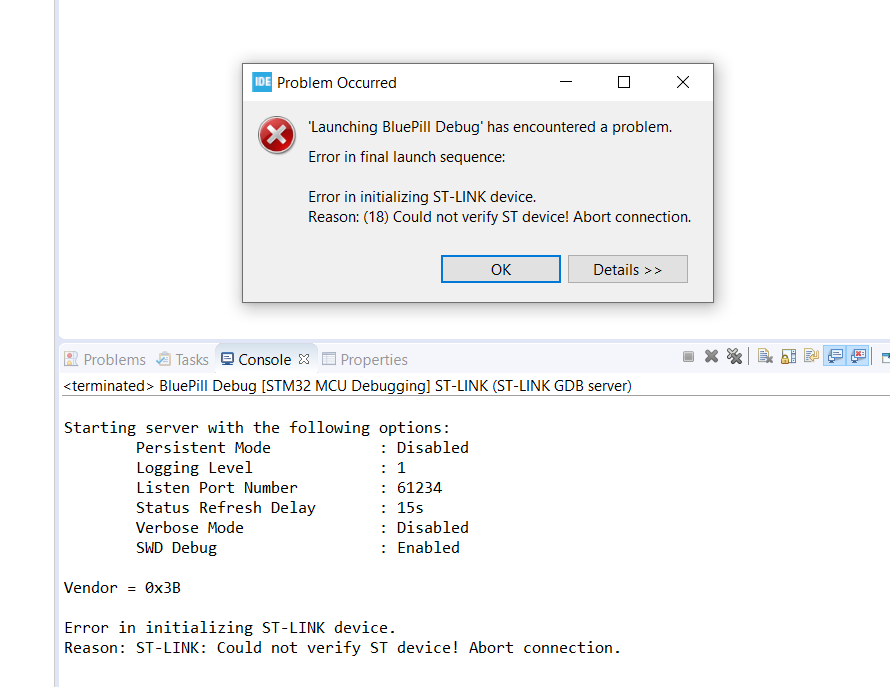

From my point off view, it looks like that GDB - server can not establish connection with ST LInk. Why, I do not know. Also, I can not understand how CubeProgrammer can deal with that MCU but CubeIDE can not.
In meanwhile, I have tried to utilize JTAG but without success. I could use CubeProgrammer, but could not CubeIDE.

2019-08-22 11:03 PM
Both CubeIDE and ST-LINK GDB-server performs check of vendor ID. If the device does not return the proper vendor code we can conclude that the device has not been manufactured by ST.
We know for sure that there are numerous STM32 clones out there.
CubeProgrammer does not seem to perform this check, not sure if it is on their roadmap or not. OpenOCD for sure does not make the check.
Based on this assumption I would assume that your BluePill is a dead-end.
I don't know where you bought the BluePill, but consider sourcing it from a more "established" distributor. :)
Sorry about the inconvenience! This is not something we can support.

With similar problem, do you mean that you get the "Reason (18) Could not verify ST device. Abort connection." error?
Ac6 with OpenOCD debugger back-end did not perform the clone device detection. CubeIDE with ST-LINK GDB server does. So, assuming your bluepill embeds a cloned ST device, this is perfectly expected.
