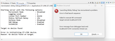

I have problems programing my custom board, I'm using a STM32F446RCT6, and I couldn't establish a connection with my board, neither from STM32CubeIDE nor STM32CubeProgrammer.
after a lot of time trying to debug the problem I found out that actually I can establish a connection (an program) the board, but only if I'm pressing two very specific buttons.
The buttons were designed as general purpose buttons, but it seems they are connected to PB3 (JTDO) and PB4 (NJRST). We thought this pins could be configured as GPIO as well, but it seems something in the way those pins work is causing trouble.

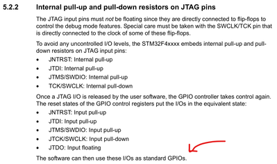

Thanks for the advice, I'm reading the AN4488:
It states that once JTAG is released by the user software, those pins can be used as GPIO's. But I can't achieve that on my board. I think my problem is that JNTRST is wired to 3.3V and JTDO/TRACESWO is wired to GND, so the board thinks those pins are not being released.

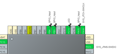

Just to be sure, to change GPIO_MODER register I need to change pinout configuration on SRM32CubeIDE?
Cause I've tried it, but my board is still not working.

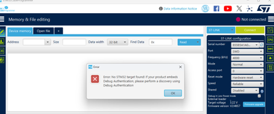

When I say that I cannot program my board what I mean is that, in STM32CubeProgramer I get this message when I try to connect:
And that in STM32CubeIDE I get this message when I try to run debug:
