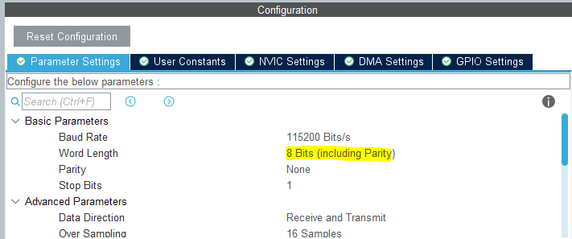

The only thing i can see wrong is that you have word length set for 7 bits instead of 8.
I'm using the same Nucleo-L432KC dev board, added the same code you have in main.c. This is the output i get.
Are you sure you have selected the correct COM port?

I got the 7 bit thing from one of the many sites I looked at. I thought it odd, but I tried it. I'll double check the com port as you suggest.
Thanks for taking the time to verify my code. It helps a lot to know it can work.
mleo2
Associate III
So, changing the toolchain/IDE environment in STMCubeMX from EWARM ( the default ) to STMCubeIDE fixed the problem. I've been using "stm32pio" tools to convert CubeMX output to a Platfomio env. This user manual is out of date.
