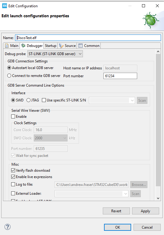

You should just need to build the project (hammer) then click the Debug icon (Green bug). You will be prompted to edit the launch configuration and on the Debugger tab you should be able to select ST-Link

Well, that's clearly the problem. When I edit my launch configuration, I see no evidence of the ST-Link on the Debugger tab.
Do I need to do anything special to get the ST-Link's gdb server installed and running?
