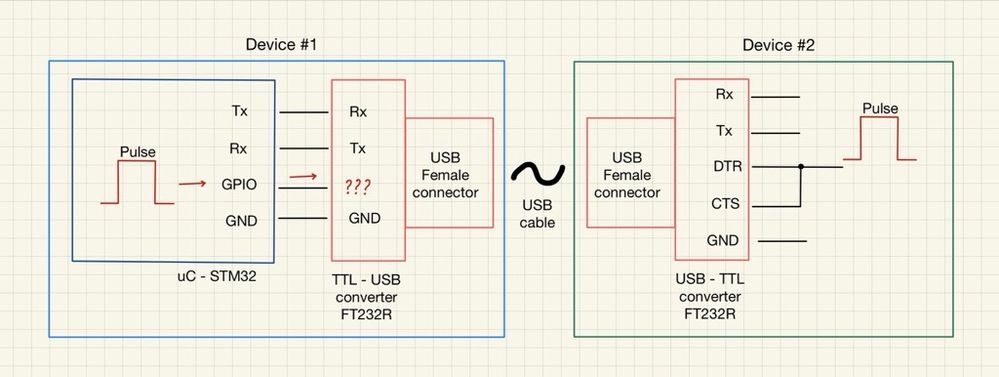

I can communicate with the device #2 using the serial communication software like Docklight Scripting by using the Manual RTS/DTR control but I need to do this with the STM32 and for that I am using the USART1 of the STM32 that will be connected to a TTL to USB converter as shown in the [Figure1] where I setup a GPIO to connect to the RTS pin of the converter of the device #1, where I want to generate a pulse of x milliseconds in the CTS/DTR of the device #2 but it doesn’t work.

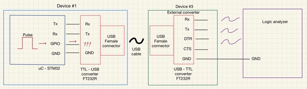

So, my second attempt was to connect an external converter (device #3) to the device #1 and check all the pins of device #3 with a logic analyzer to see if I manage to generate a pulse in the DTR or CTS pin of device #3 but it didn’t work. I even connected the device #3 with the software Docklight scripting and I can see the pulse generated in the DTR pin with the logic analyzer when I press the DTR button in the software.

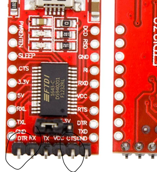

How are you connecting those lines, maybe post some pictures or wiring?
