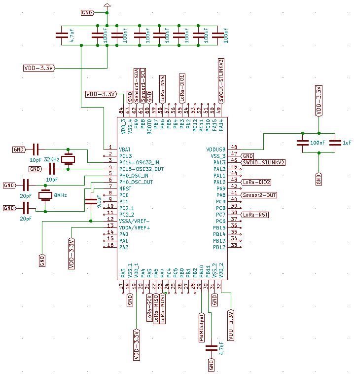

Can anyone who has in-depth knowledge about pinout of STM32L476, please verify my design?
Prajnyajit
Associate II
I've attached the schematic of the MCU. In my application, I'll be using sensors, LoRa, and a PWM output. I have prepared the schematic considering the situation that I'll be able to upload a program to the MCU on board. Please let me know if anything is wrong with this. Your prompt response is going to help me a lot.
Thank you.

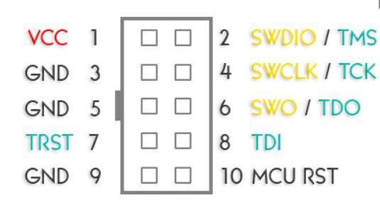

If I use an ST-LINK V2, whose pins are as shown as follows.0693W00000FAiyeQAD.jpg
will it work if I connect the following?
  1. NRST (of MCU) to TRSR (ST-LINK V2)
    1. PA13 to TMS
    2. PA14 to TCK
    3. GND to GND

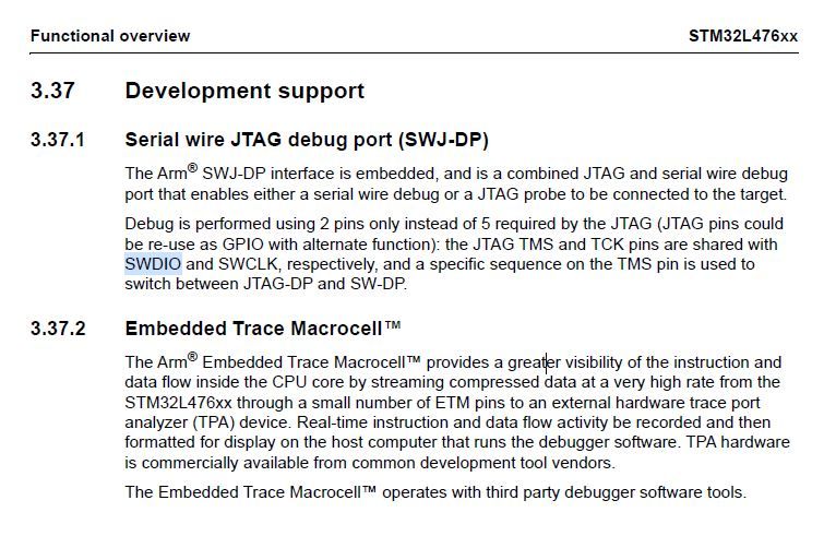

Aksing you to get confirmation. In this way can I debug and upload the program to MCU instead of a complicated BOOTloader and UART? If so, should I pulldown BOOT0 to the ground?
If I do this, will it add debug functionality and work well? I have connected BOOT0 to GND this time and STLINKV2, 2 pins to MCU's required 2 pins. As per the datasheet, these 2 pins can be sufficient to debug. What is your opinion on this?
