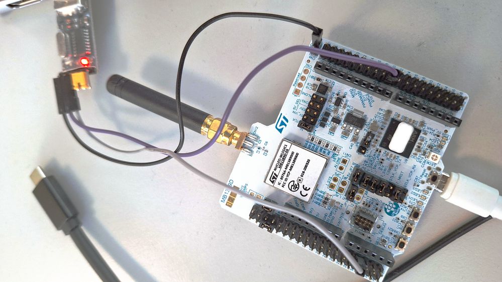

I can confirm the bootloader is working on PA9/PA10,
Here is my setup so you can compare with yours:

2025-04-14 8:28 AM
Thanks a lot Mike, I don't know what I was doing wrong. I just disassembled my setup and done it again to copy your photo 1:1. That made a trick!
