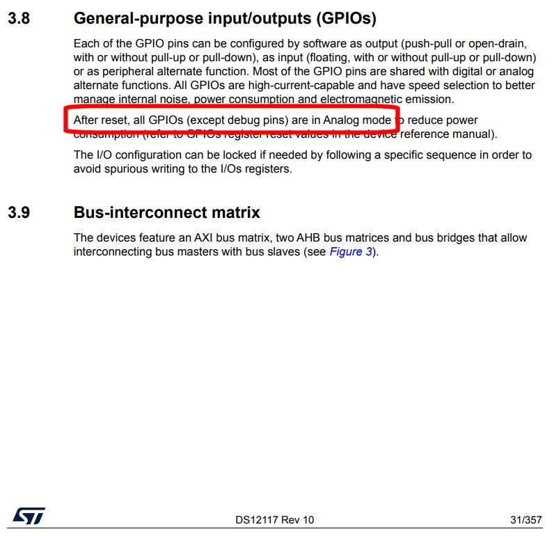

Reading between the lines, I would guess the default reset state is pull-up, so this (just) switches on Q3 NPN transistor. Maybe through an opamp and NPN, some logic can be made to display an LED when reset.
Thanks.
2026-04-07 4:16 AM
No need to guess:
https://www.st.com/resource/en/datasheet/stm32h753zi.pdf#page=31
via: https://www.st.com/en/microcontrollers-microprocessors/stm32h753zi.html
