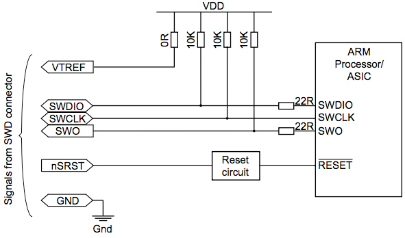

Just to confirm to program the MCU via SWD I need to tie the boot0 to ground to boot from user flash, therefore the SWCLK will also be pulled down also. The SWDIO and SWCLK should be pulled up to 3V3 according to the following image for arm cortex processors:
The datasheet does not talk about any detail about boot0 being shared with SWCLK, and I want to ensure that I can program the MCU. I have SWDIO and nSRST pulled up and SWCLK pulled down.

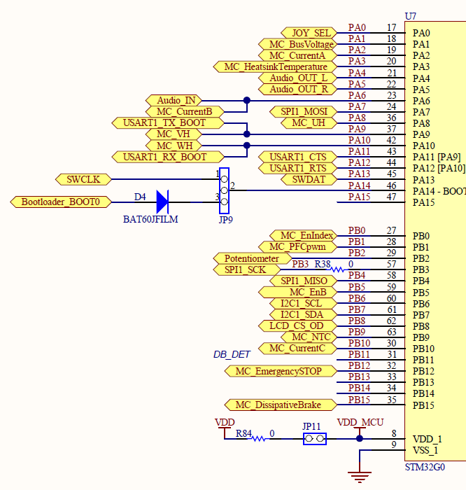

If your hardware needs BOOT0 pin to boot in a specific memory area, you can use a jumper to select SWD programming or Boot as in the STM32G081B-EVAL board below:
