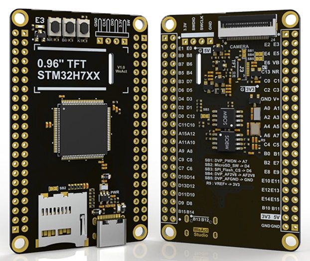

The WeAct and DevEBox boards are an interesting compromise.

The we act studioboard seems cool but I’m not sure if it build it display connection would work with a touch screen.
