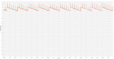

2025-10-13 12:08 AM
Okay, we solved it. We were only supplying power from JP2. I think, somehow DC switches pass current backwards and increase the consumption. So when we plug in the SMod+ adapter board and apply power (while keeping the uart GPIOs in PullUp and GPIO 15 in PullDown), the consumption started to oscillate between 1.25uA and 1.45uA:
But, I think DC switches still have a problem with reverse current.
Thank you.
