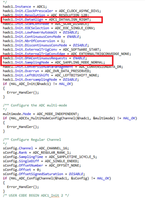

Thank you for your reply, I've tried to make it work only with ADC1 and still no DMA option available at 12-bit or 16-bit. I also naively attempted to add the missing code to ADC1 configuration in main.c (see figure) hoping it would take it, it copiles but does not work.
Any suggestion to make it work? At least only for ADC1 to start.
