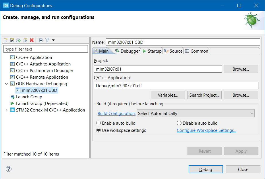

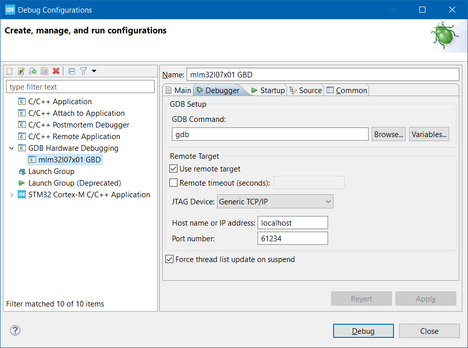

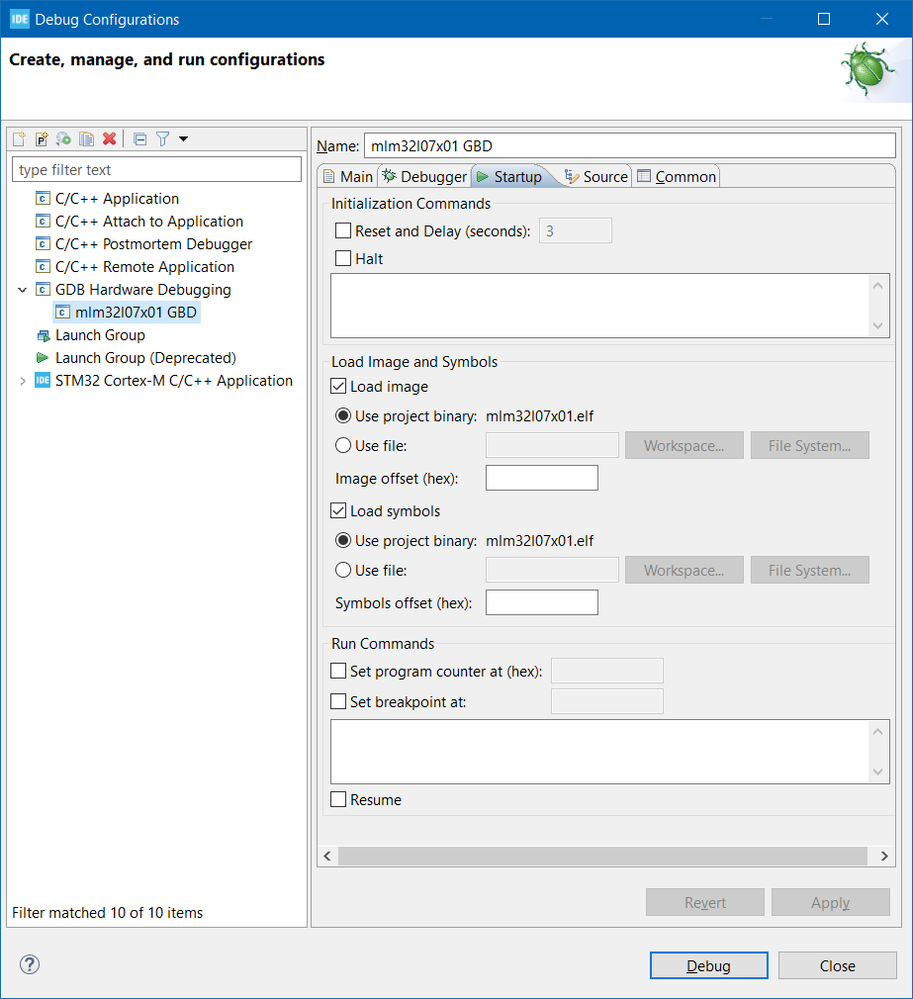

So far, I have defined a 'GDB Hardware Debugging' Configuration:

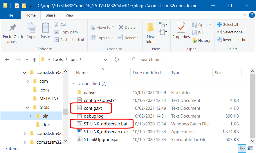

You need to manually start the GDB Server before launching the Debug:
STM32CubeIDE_1.5.1\STM32CubeIDE\plugins\com.st.stm32cube.ide.mcu.externaltools.stlink-gdb-server.win32_1.5.0.202011040924\tools\bin
The 'config.txt' needs to be edited to specify the path to the STM32_Programmer_CLI executable - see comments in the file
then run the .bat file

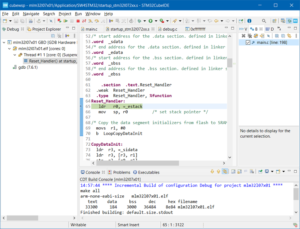

When I start a debug session, I see:

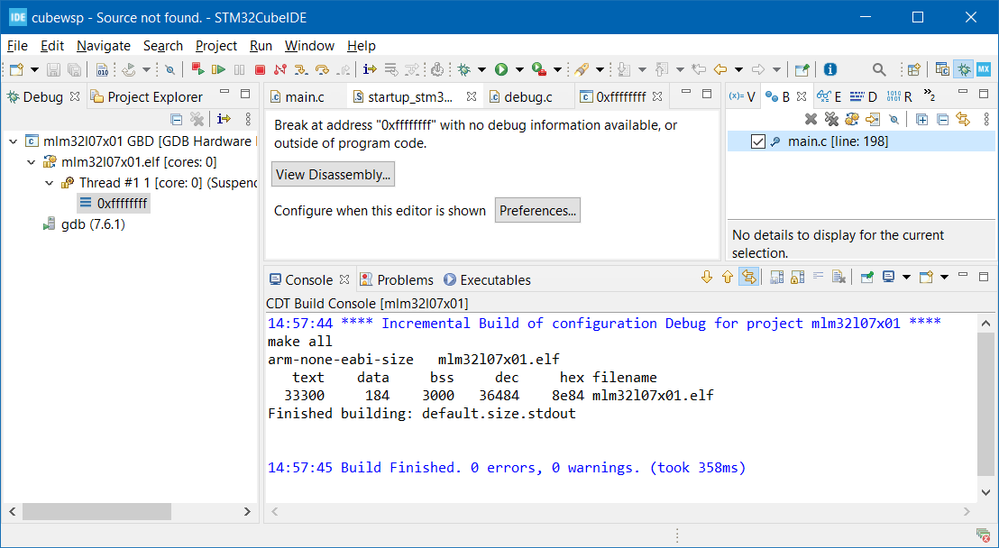

'Resume' goes to:
and there it seems to be stuck.
