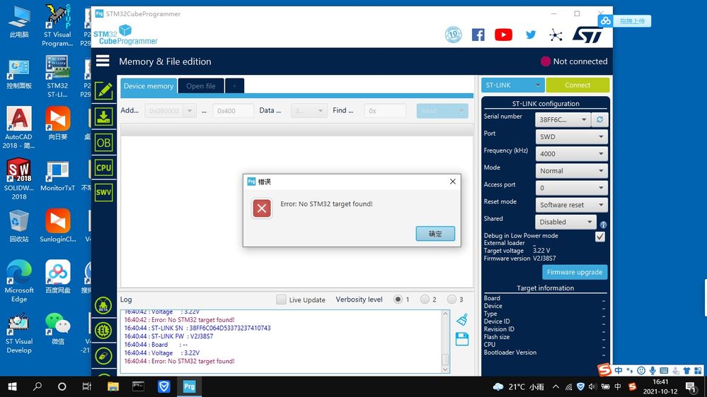

I try to connect PCBA board with programer tool STlink-V2, but show can't connect target STM32G030XXX from STM32CubeProgrammer software interface. see below image.But I try STM32F030XXX can connect the target, please let me know what is the problem for STM32G030XXX?
Check if STlink-V3 can meet this requirement?
2021-10-12 3:07 AM
Have you upgraded the ST-link firmware? go to ST-LINK > firmware update or through this Link STSW-LINK009.
Maybe you should check if the MCU is correctly powered and connected in the right pins !
Imen

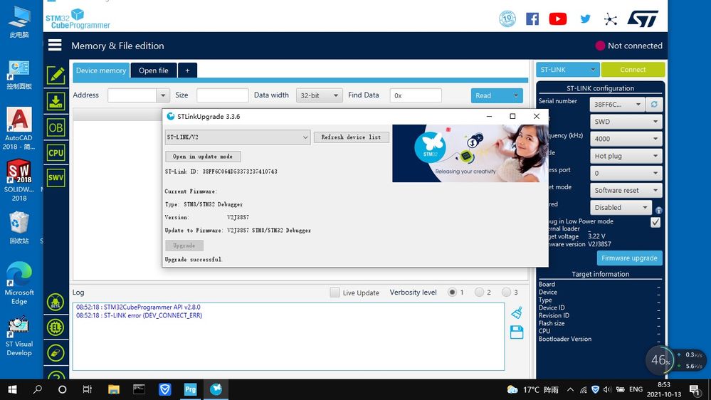

Yes, I already upgraded the latest FW successfully, see below image.
I can make sure the pin contact is very good and powerd on by 3.3V from STlink-V2 tool. Since this tool has been using STM32F030XXX progrmaming, only changed to new MCU type STM32G030XXX, other no change. programming point is same as STM32F030XXX.
I checked PCBA TopBand supplier, was told if the STM32G030XXX was encrypted protection after programming by them, STLink-V2 tool can't be used, if no encrypted protection STLink-V2 tool can do programming. But you mentioned even encrypted also can be used for unlock and programming, please help, thank you!

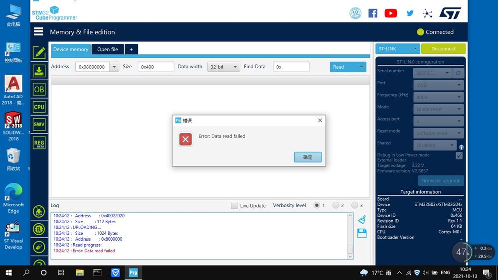

Sorry, I selected under reset mode can connect the device but show "data read" failed, see below image. This was casued by third party chip was encrypted protection?
2021-10-12 8:23 PM
But I can't find the unlock item from STMCubeprogrammer menu. Do you know how to unlock encrypted protection STM32G030XXX?
2021-10-14 10:24 AM
Hi @Ayang.1 ,
Is the read protection byte checked? maybe try uncheck it.
