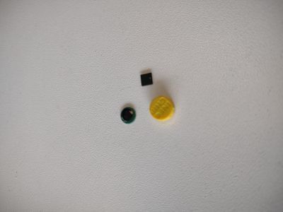

i'm using the default NFC08  antenna, trying to read RF37S114HTFJB and
https://www.infochip.com/products/rfid-tags/hf/duraplug8/ 
I don't know if it uses enable/wake up mode. how can i check this out?
- I found the aatMeasure function in st25r3916_aat.c but debugging never comes there so i suppose it does not use AAT?
Goal of the project is to use NFC tags on metal parts to detect different tools in our machine.  the tag should be small. Reading distance should be larger then one centimeter 3cm would be nice.  I want to design the reader by myself.  The tags we want to buy ready made.  Can recommend tags for this  please?  we do not need a lot off storage space in it, the standard ISO is not important for us.
If i cut off the antenne of the NFC08  and solder an antenne with ferrite on it will it tune itself if i use the NFC08A1_PollingTagDetectNDEF demo?

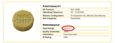

Brian TIDAL
see the technical specifications of the duraplug8 tag:
Rgds
BT
by default the firmware uses the analog config to set different DAC values for the varicaps to control the emissions in reader mode and the loading effect in card mode. Thus the automatic tuning is not used in this use case.
Please see the AN5322 ch.8 for details in case you want to play with it. I am not expecting any improvements by re-tuning.
You say you experience about 10mm. Looking at the provided data the tag has a guaranteed operating range of 2.5mm. So you are already 4 times beyond.
BR, Ulysses

thanks for pointing me to fact I didn't read the specs very well :face_with_rolling_eyes:.
It will be hard ( or impossible ) to find an on-metal tag of that size that works at a distance > 10 mm?
