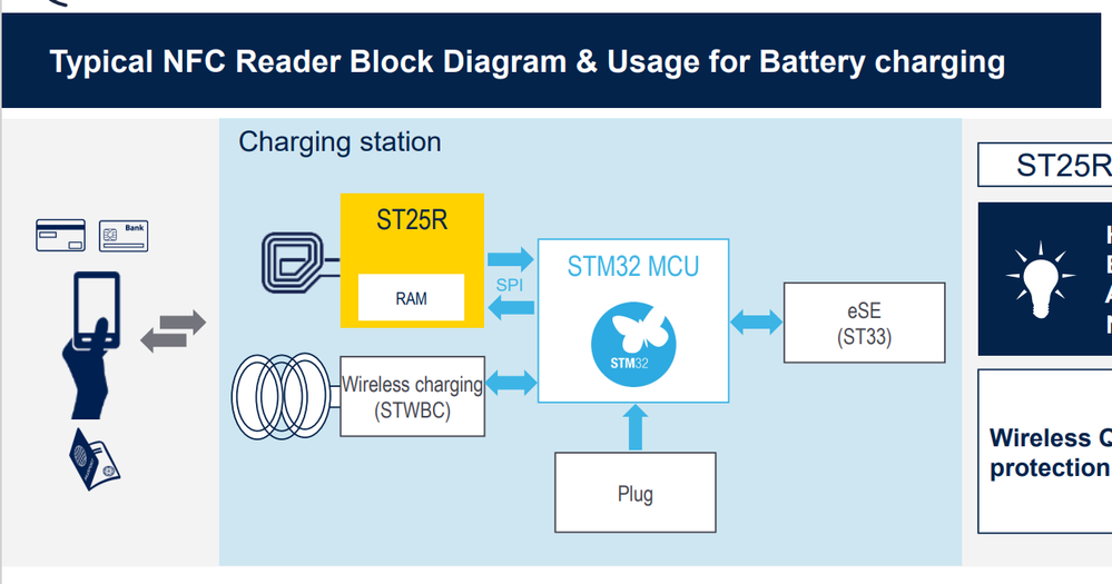

I have learned that the energy of the EH pin of ST25 is too small to meet the needs of the project. Can I use Qi wireless energy collection to solve the problem of energy collection and realize the transmission of sensor signals to the reader without power?
2023-09-12 11:30 PM
The STWBC2-HP is going to be placed as a wireless charging (STWBC). As you can see in the flyer screenshot you have downloaded.
Best regards.

Hello @Schuyler
As mentioned in the screenshots, you can use the wireless charging Transmitter. And I suggest you to use this STWBC2-HP.
This component is QI compatible and can do the job.

The requirement of my project is to realize non-power acquisition of NFC, in which signal transmission is completed through NFC antenna, but the energy obtained is too small to wake up MCU, so how should I match STWBC2-HP? Can This component be used together with ST25dv?
2023-09-12 11:30 PM
Best regards.
II
