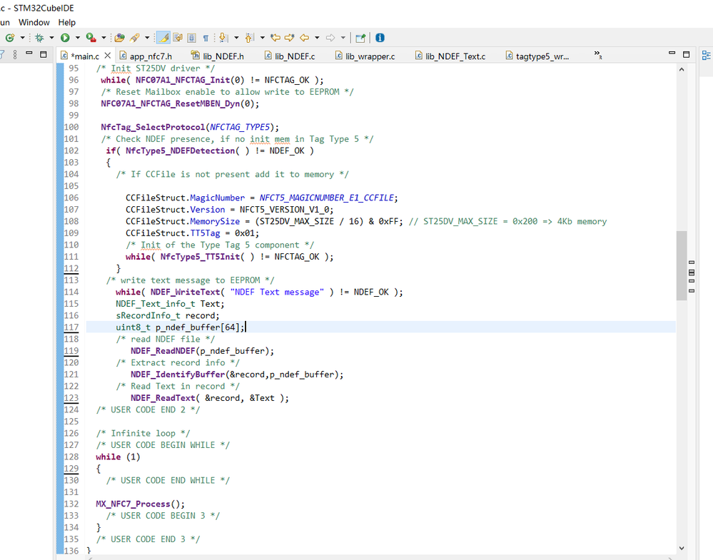

I've seen ndef. lib file, but I did not see the function of this code in the main function of STM32CUBE IDE, and the phone could not read any messages after downloading the program. Is there any relevant example that can be written into NDEF? Hi, I read the message from ndef. lib file, but I did not see the function of this code in the main function of STM32CUBE IDE, and the phone could not read any messages after downloading the program. Is there any relevant example that can be included in the information of NDEF?
The following is the code I designed. Why can't NFC Tag APP read any NDEF information
