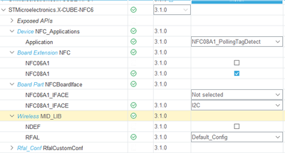

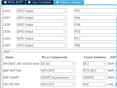

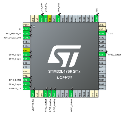

Software:
• In the Cube MX project, I disabled SP1 and enabled I2C1.
• In the "X-CUBE-NFC6" settings, I selected I2C:

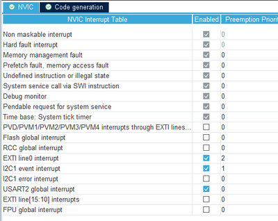

Make sure to enable both I2C1 event interrupt and I2C1 error interrupt. What value have you used for the pull up resistor? Make sure that the internal GPIO pull-up for the SDA and for the SCL are not enabled
Why do you have USART2 interrupt enabled?
