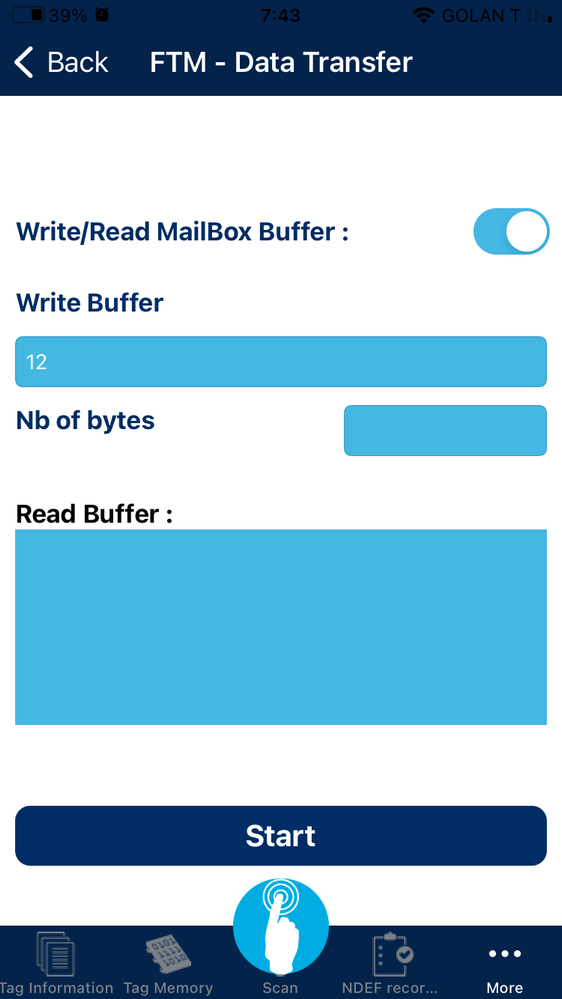

While doing an FTM transmission from RF to I2C and reading the MB_LEN_Dyn register, it will always report a length which is 6 bytes more (or 7 after the increase by one in my code) than the actual message length.
Below is the code of the ISR handling this. Can you please let me know what am I doing wrong?
On the mobile side, I am running the NFC Tap and using the FTM - Data Transfer screen.
Thank you,
Nir.

2022-09-12 2:11 AM
Hey JL,
Thank you. Please see attached the screen shot from the NFC tap. In this case, i was sending "12" which is suppose to be 2 bytes long.The output i got for this from my serial logger is:
113, 7 , 5, 49, 50, 23, 4, 219, 103
As you can see, there 9 bytes here. Only the bolded ones (which I have bolded here) are the actual data (ASCII representation of 1 and 2). I do not know what the App sends out but I thought it would
just be the data itself. Is there a prefix or suffix sent?
Mind you, I found a clue to this mystery. The second byte (in this case 7) will always be in the value of the length i get (in this case 9) minus 2. Maybe this can help explain something.
Thank you for your help,
Nir

2022-09-12 6:54 AM
Oh! I spent almost 5 hours trying to figure out what's going on! I think it will be a good
idea to note this somewhere so that someone using the NFC Tap with a dedicated hardware would be aware of this.
Anyway, thank you for your help!!
Nir
