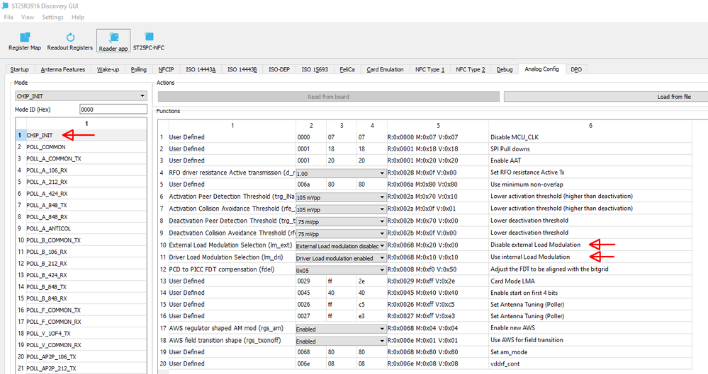

is there a simple way to enable the EXT_LM signal in the STEVAL-ST25R3916B board through the ST25R3916 Discovery GUI? In the Card Emulation tab I didn't find any option. We have to modify the firmware and reload it?
Thank you
Cla
2023-06-29 4:06 AM
Hi Cla,
this can be easily done via the GUI, just read from board or load the default file and adapt as per this picture. The setting for Ext_LM is inside CHIP_INIT:
When writing to the board you have also the option to put it into MCU flash to be used as default.
Regards, Ulysses
