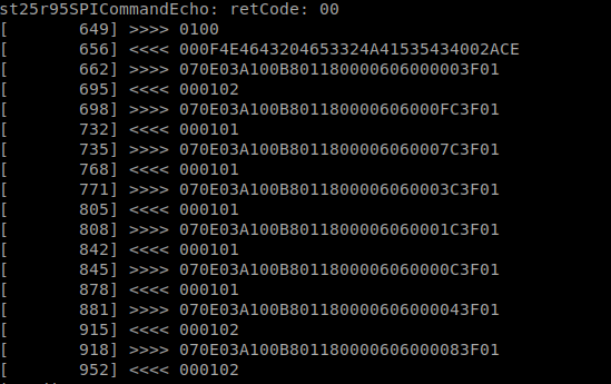

Also I have checked st25r95CalibrateTagDetector() everyting seems ok I am getting ERR_NONE. Currently I don't have the X-NUCLEO-NFC03A1 board.
This is the output from st25r95CalibrateTagDetectorRgds Suad

st25r95CalibrateTagDetector() returns the Dac Reference Value (DacRefValue). This DacRefValue is used to derive the detection guard band [DacDataL; DacDataH]:
See 5.9.5 Tag detection calibration procedure in the ST25R95 datasheet.
The Dac Reference Value is stored in gRFAL.wum.CalTagDet during rfalInitialize().
So you should not use hard coded value in st25r95Idle(), but you should use (gRFAL.wum.CalTagDet - 8U) and (gRFAL.wum.CalTagDet + 8U) as in the rfalWakeUpModeStart() reference code.
I had a look to your output of st25r95CalibrateTagDetector and if I am not wrong the returned value is 0x08. This looks very strange to me. Can you make sure to run the calibration procedure with no tag within the antenna RF operating volume? Is there any shielding or ground plan under the antenna?
