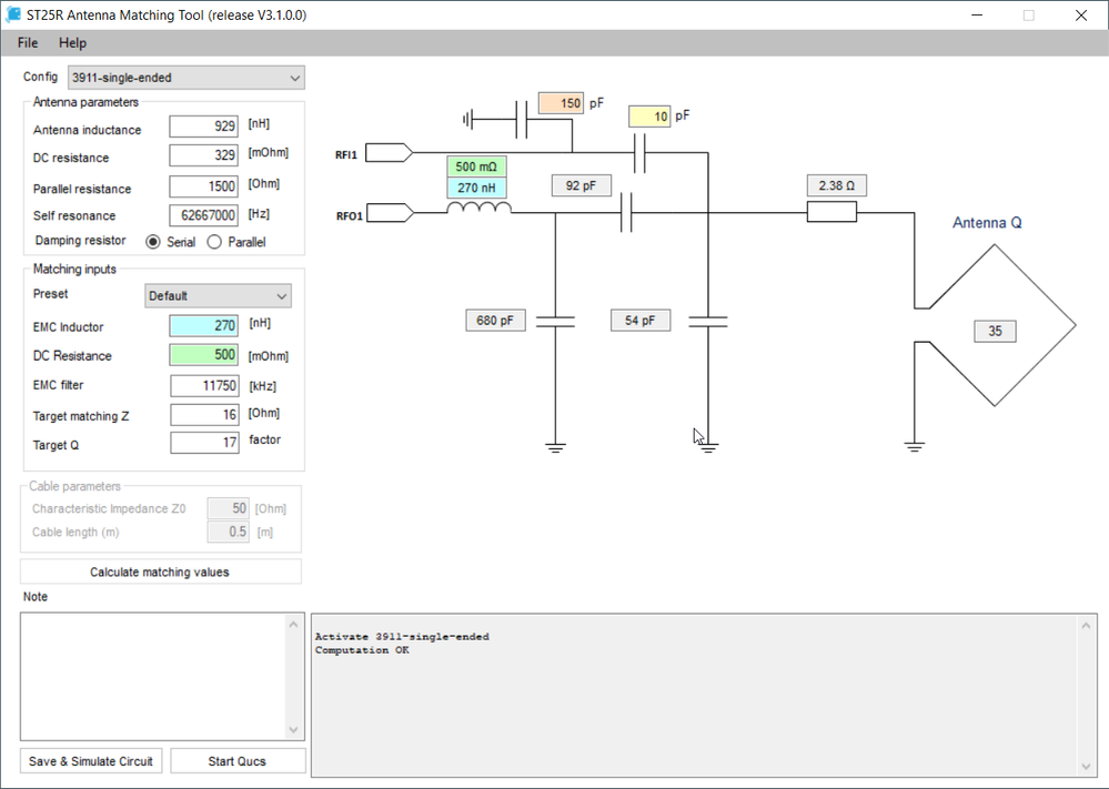

The ST25R3911B can either drive one antenna in differential mode or two antennas single ended. The "single" and "rfo" bit of the "IO configuration register 1" can be used to switch between the two antennas.
In single ended mode for each antenna you will need one EMI Inductor, EMI capacitor, one series capacitance, one parallel capacitance and a damping resistor.
The latest ST25R Antenna matching tool helps you calculating the required components. The same process as for differential antenna can be used.
Important is, that the RFO1 is connected with the RFI1 and RFO2 with RFI2.

However the ST25R39 devices (i.e. ST25R3911B and ST25R3916 + derivates each) support the option to drive two single-ended antenna instead of one differential antenna. Both devices have a single and rfo2 bit which can be used by application software to switch between two different antennas.
Single ended topologies are also supported by STSW-ST25R004
Maybe that is an option for you?

So I understood that we can use OR a pair of ST25R3911B (one for each coil, differential mode) OR a single ST25R3911B driving 2 single ended coils? About the second option, could you provide a simple diagram of it? How I will do in schematic about second option? Would it be the FIRST COIL connected to RFO1/RFI1pins and the the SECOND COIL connected to RFO2/RFI2pins, both in single ended mode?
